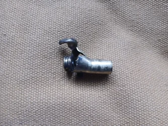

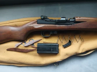

I took an old first-generation Universal M1 Carbine to the range yesterday to burn up the last 50 rounds of .30 Carbine I had before trying to sell it. The gun had been cleaned and serviced regularly in the last few years and was running pretty well. The first couple of mags cycled flawlessly. However, about halfway through mag number three - POW! I was stunned for a few seconds and not real sure what just happened. As the fog began to clear I saw that a grenaded round was stuck between the chamber and the partially opened bolt. Remnants of the mag, which also pretty much exploded, along with the remaining unfired rounds, were scattered about. I eventually noticed chunks of the stock blown around as well. And drips of blood were beginning to plop down off the end of my snout.
After churning through tens of thousands of rounds over the years, this was a new experience for me. At first I thought maybe I got a hot charge from the factory but after thinking about it, which I did a lot of in the last day, I’m wondering if the rifle fired with the bolt being out of battery. The blowout of the cartridge is near the base, possibly indicating the round may not have been fully chambered. I suppose I’ll never know.
I haven’t inspected the bolt or chamber for damage yet but I’m pretty sure the rifle is heading for the scrap heap; doubt I’d ever be able to trust it again. As far as damage to the user, I caught a few small pieces of shrapnel to the mug but the bleeding stopped quickly with pressure applied. The only other issue was the bit of rash I got after soiling myself just a smidge. In retrospect it could have been a lot worse, and I’m really glad it didn’t happen with one of my .308’s.
If it were in my possession, I would strip it of as many reusable parts as I could, including the undamaged wood parts, and sell on eBay or elsewhere - so many gun lovers always looking for spare parts; and, it's not like using most parts will cause the next rifle to blow up. I do this with many damaged firearms, with salvageable parts, as I can acquire, especially since some of my rebuilds are "resting" and awaiting my finding of hen's teeth replacement parts. Otherwise, I'm glad to hear you experienced no serious injuries - I've had 3 pistols do the same thing.
From the looks of that shell casing I would agree it was an out of battery explosion. The later Universals were vulnerable to this (they modified the bolt design being the main reason) but I haven't seen it happen with an early one. The military carbine bolt is designed to prevent the firing pin from being driven forward by the hammer unless the bolt is fully closed. If not closed the hammer energy is dissipated pushing the bolt into battery. Don't know what caused it in this case but there should still be a number of good, usable parts left.
A stuck firing pin was my first thought when I read the original post, but who knows what could have happened. Luckly no serious injuries. I agree I'd have a hard time trusting that rifle again.

A stuck FP can cause an OOB discharge. There may be no problem with the mechanical parts. Replace the wood & magazine, be sure the FP channel is clear and not gunked up, get the GS to check it out. Then decide if you should part it out or not.

The cartridge that exploded appear to be unsupported by the chamber, which would indicate it fired out of battery. Take a real good look at your firing pin, it could've been stuck?
That was definitely an out of battery fire! You can clearly see that the front half of the case was fully contained in the barrel and didn't swell but the rear was uncontained. Look at the bolt and see if the firing pin is stuck in the out position. Also post a picture of the rear of the fired case so that we can see the firing pin strike. I would not be surprised to find that your ejector and extractor are missing!

I'd agree it is an OOB situation. The most frequent cause is a stuck firing pin igniting the cartridge before it fully enters the chamber. The bolt would tell you the full story. I'd disassemble it and see what the interior of the FP channel and the FP look like. Replacing the entire bolt assembly might fix the problem.
