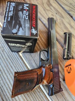

Picked up a model 41
Jan 10, 2009
6,344
14,283
Western ,Ma.
I've shot these a few times and they were always a bit too expensive to try to obtain one of my own. This one was in a range I was comfortable paying 700.
Figured if it didn't like me it would be easy enough to recoup what I spent.
Took it right to the range and it did like me.....a lot.

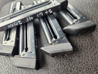

Function was 100% with the two mags I had.
One is the orange follower 12 round and the other has the metal follower.
The serial has a BMC prefix any help on the year ?
You were lucky scoring the 12rd mag . They are not exactly cheap , if you can find them . I got 2 here a couple of years ago , and one in the package at a S&WCA symposium . Mine dates to 1978 , and the best thing I did was pick up a 7.375in barrel here . That really opened it up .
Nice pickup, and for $700, a relative steal. I think BMC would make it 1998. Definitely after ‘97 with the laminated stocks.

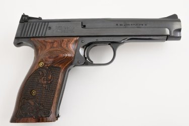

I believe you are mistaking natural wood grain for laminations. The stocks do not appear to be laminated to me. Here are a couple of Model 41's with laminated stocks for comparison:

In 1992 S&W suspended production of the M41 when the factory was moved to Maine. Production was resumed at the new facility in 1994 as what we call the “new model” whose safety did not lock the slide when engaged. Your M41 has the older safety with the tab that fits in the slide when engaged locking the slide. Production in Maine, I believe, started with serial number UAA0001. Your M41 could well have been shipped from existing stock in 1992 or 1993.
From my database:
BMC0677 shipped in December 1992
BMC2873 shipped in August 1993
The 12 round magazine was only produced from 1992 to 1994 so it is a bit of a rarity but could be original to your pistol.

Thanks all
Thus far I've tried that winchester m22 and some federal auto match in it. Both are 1200 fps or more.
The gun ran both with 0 hiccups.
I did have 2 duds but no gun related issues.
