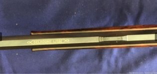

Bought this gun and it's a piece of art. Made in the early 1900's and possibly restored at some time. Tried 22 Std Vel and the empty case stuck in the chamber fairly tight. It's a very tight European chamber, most USA made ammo wouldn't fit. Used SK Standard in it.
Started to shoot 22 CB Long and the empty cases got harder to extract, the 5th one stayed in the rifle till I got home to use a cleaning rod to push out.
Before I ruin anything, figured I would ask here first. I glued an empty 22 cases at the end of a flexible plastic rod to insert from the chamber. This way nothing will rub against the action and scratch it and I am polishing the chamber only. Was going to buy some Flitz to put on the case and slowly turn with a drill to polish the chamber. The gun is roughly 120 years old.
Safe?? I want to shoot the gun even if I have to buy 22 Long CB's. Thanks, Larry

I'd clean the chamber only with a good cleaner, followed by a brass/ bronze brush and clean patches before I'd start polishing. There could be a lot of old, hard carbon deposits there.
What BE Mike said. The less it is altered the better. Have you tried a chamber cast?
Froggie
I used a cleaning rod from the muzzle with a brass brush by hand. It helped but needs more cleaning and a drill would work great. I honestly don't think it's been fired much over the years. Couple good ideas so far, will use some bore cleaner first.
Used valve grinding compound to crown a muzzle, way tooo abrasive. Need some more ideas, will start with what was said so far. It's a .22 long rifle, no chamber cast. Thanks, Larry

I would remove the barrel before I did much in the way of trying to polish the chamber. Even if you rod flexes you going to have more pressure on the top rear and front bottom of chamber.
Even with the barrel off I would seriously think about running a match grade finishing reamer in it, over polishing. 4Dreamer will rent you a match reamer with a floating pilot for $45 plus shipping.

I will probably spin a brass brush from the muzzle with some scrubbing alternating with bore cleaner. The fired cases didn't have to be pounded out just pushed with a rod inserted from the muzzle. Couldn't pry them out with a finger nail as they got progressively harder to extract.
The use of a reamer would definitely cure the problem but removing the barrel won't happen. I knew bidding on this rifle it was a custom gun nicely done. With the rifle in my hands I could see the quality of workmanship. It's a piece of art. I don't want to let anyone remove the barrel afraid of damaging it somewhere.
I want to shoot the gun and enjoy it. If this was my 12/15 Martini I wouldn't hesitate having the barrel removed. There was a thread on this rifle in the other brand gun section, "Custom Martini Rifle of My Dreams Gun is coming-shots fired" . Thanks for ideas to solve the problem, Larry
