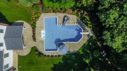

Years ago when living on Long Island I had similar issues. After checking every possibility over weeks I finally figured it out! The wall mounted skimmers are attached to the plumbing with a pipe at the bottom of the skimmer. When the original installation was done, they used wooden 2 x 4s to prop up and hold the skimmers in place (in the dirt). Over time, the 2x4's rotted out and the skimmers started to bend over from the weight and cracks developed in the skimmer pipes.
I had to saw cut the concrete around the top of both skimmers (neatly but larger than the skimmers themselves), dig holes about 4.5 feet deep and replace the skimmers. When I replaced them I used bricks to support the skimmers instead of 2 x 4's that will always rot. After replacing both skimmers I used pavers to fill in where I had cut the concrete. Had I used new concrete it would have looked terrible because of the mismatch. I used contrasting pavers and they kind of looked like they were a totally different color on purpose for decorative purposes. You can see the replacement pavers in the pictures below - enlarge pic's to see better. They looked different but IMHO better than fresh concrete would have.
This was a fairly exhausting job but from what I understand a common one issue since pool installers don't really
think about or care about what will happen years down the road. I hope for your sake this isn't the problem but if it is, the only way to properly fix it is to replace them. If you do not want to tackle this job yourself (and it is not an easy one) your pretty much relegated to hiring someone which would probably cost at least a few grand, depending on the prices in your area. I wish you good luck.
