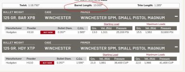

What barrel lengths are those loads getting 1700+ fps from? My guess is a carbine. The Hornady manual lists an 8" Colt Python as its test gun for .357M loads, and their max load for the 125 JHP gives 1500fps, using either H110 or Win 296. I wouldn't think your 686 with a 6" barrel would even go 1550 when using the load/velocity data Hornady states for the 8". That said, Alliant Power Pro 300-MP gave velocities at 1600 fps using 20.4 grains behind a 125 JHP, compared to H110 @ 19.9gr./1500 fps and Win 296 @ 20.3gr./1500 fps. The Power Pro is slower than either H110 or Win 296.

Hodgdon doesn't list their test barrel with their online data. Maybe they do in their book. But I assume it's all relative so whatever I can get with Enforcer will probably be slower than what I can get with 296 or 110. Western Powder does list their test barrel for the Enforcer data and they say 6".
