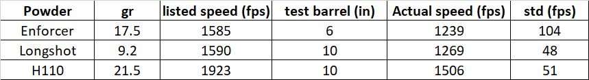

Finally got around to making and testing some higher power 357magnum loads. I compared 3 powders: Enforcer, Longshot, and H110. I used Starline brass, Federal SPM primers, and 125gr Hornady XTP bullets. All were made on my Dillon SDB. All were more or less the midpoint in the listed load range. All were shot with my 686 Competitor and 12 shots for each powder. The "listed speed" is just the midpoint of the listed range.
Obviously the H110 had the highest speed. I would not say it felt "taxing" to shoot any of these loads. I could definitely feel the H110 loads a bit more than the other two. I was of course wearing glasses but I am pretty sure something was blowing back and hitting my face (like little prickles). All the speeds are a lot less than the listed speeds but the Hodgdon data was a significantly longer barrel and I assume even the Western Powder data was not done with a revolver (hence extra gas leak). I did some target shooting with the H110 load and it was pretty good. I wouldn't say it was less accurate than my much slower target load which is 158gr at about 1000fps with AA#5.
So, at least for me, the verdict for high power 357 is H110. They were fast, accurate, and fun to shoot. I shall make 100 more tomorrow. The only thing about H110 is that it seemed to barely leave room for the bullet and the listing goes up to 22gr.
Oh and I had zero FTF's using Fed SPM primers. I had previously made some of the Enforcer loads with CCI SPM and some of those FTF'd. I've had FTF with the CCI SP primers in this long also and we discussed that in a different thread over a year ago. I guess the Competitor has a lighter trigger that doesn't always play well with CCI primers.

Thanks for the detailed post. I do think this load is more about "gee whiz" and "fun factor" rather than anything particularly practical.
IMO, formulated over 40 years of loading, hunting, competing and plinking with the .357 magnum, I'd say you're exactly on track.
