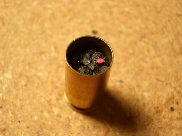

Red Dot has reasonable volume density so a double charge will be spilling over a 9mm case and should be quite noticeable in the .38 spl. Fast powder, lower level velocities for target loads.
To show how Red Dot fills a 9mm case, the picture below shows a 9mm case with 4.2gr of Red Dot.
