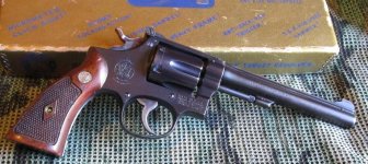

The ramp base was pinned to the barrel with two pins on the 44 Magnum from the beginning. The pins were polished flush to the barrel rib on revolvers finished in bright blue and left unpolished (proud) on revolvers finished in nickel until around 67-68. You can see the pins in the photo of the 44 Magnum shown below that was shipped in November 1956. The ramp base began to be forged with the barrel in the late 1960s and the red ramp pinned to the base with a single pin for revolvers with a 6 1/2-inch barrel. This did not occur for revolvers with a 4-inch or 8 3/8-inch barrel until around 1972. Click on the photo for a better look.
