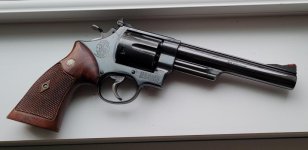

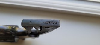

When I was at home visiting my Father a couple weeks ago he gave me his Pre-29. The serial number puts it right around the time they started with model numbers but mine does not have one. So would this gun be from 1957?

This info is from a previous Doc44 post on the 4 screw pre-29s. "The directive to delete the upper side plate screw for N-frame revolvers was issued in Sept 1956 and 44 Magnums with 4 screw frame and no model number first appeared in Feb 1957 at aprox SN S167500. During the first half of 1957, 44 Magnums with a 5 screw frame and 4 screw frame were shipped. Stamping of MOD-29 in the yoke cut began at aprox
SN S183900, so there are aprox 16,400 SNs for all N frame models that could have 4 screw frame and no model number. If the Model 29 comprised 20% (a guess) of those manufactured, then aprox 3200 44 Magnums with a 4 screw frame and no model number may have been made. This is just over half the number shipped with a 5 screw frame and no model number."
Since there are fewer 4 screw non-model stamped pre-29s it would be reasonable to think those would be more valuable but that is not the case. There was a post here a week or so ago wondering about the difference in value and for a high condition one the consensus I think was that that difference would be in the $1k to $2k range.
Very nice revolver you have, enjoy.

twaits: What a superb gift you received from your father. A 4-screw .44 Magnum is an outstanding revolver, and quite valuable. I hope that you keep it as a keepsake and pass it down when the time comes.

Nearly all of the 44 Magnums in my database with a serial number in the S179000 range shipped in 1958. They would have been shipped with a dark blue/black presentation case with a smooth exterior.
Bill
