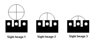

It is my understanding and experience that the M&P line uses a combat sight picture (#3) and the front dot should be placed on the intended POI as opposed to a 6'O'clock hold. On a combat pistol if either #1 or #2 sight pictures are used then the POI will be low.
One thing that's interesting about the talk about lining up the dots vs. the top of the posts is that almost all of the 3-dot systems seem to use the same dot size on the front & rear posts. This makes the front dot seem smaller as it's further away and and also encounters parallax issues. This naturally means that there's inherent "slop" if using the dots to line up the image instead of the tops of the posts. However, with my older eyes & corrective lenses it's nearly impossible to get a decent image if I focus on the front sight so I have to focus on the target and use the dot's & out of focus sights to get things lines up. At normal defensive distances this is more than accurate enough for CoM hits.

so you want that #3 picture right? Because the other day when i was shooting..every single shot was low. So i tired to fix it....
I fixed it by almost dipping the back end of the gun down so the front sight went above the back sight lines and i was dead on....it was strange
No, the M&P, just like most guns, is intended to be used with sight picture #2 from the post above. This has been tested by many on this site from a bench rest and found to be true. However, the difference between #2 and #3 is so small as to be insignificant for self defense shooting.
