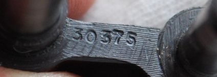

This is from a Chiefs Special (before they added Model 36). You
can see the assembly number on the yoke and next the serial
number on the yoke (2 shots).
