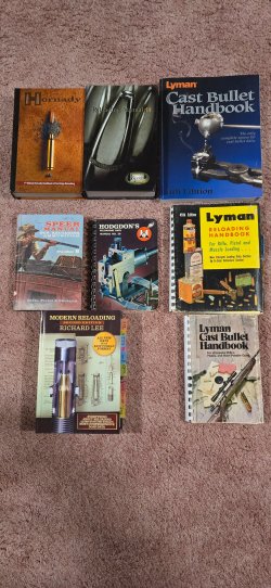

Just some of the manuals I have accrued since I started reloading in 1972.

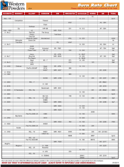

Since it appears you'll only be reloading 9mm, 38/357, 44sp/44M, 45, you'll only have to contend with the upper 28 lines of the burn rate chart.
