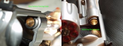

I think these two statements make a lot of sense.
"Sometimes I think GS's, equipment & tool manufacturers just invent new ways to make more money."
And
"I'd like to know is that IF 11º is such an improvement over Factory specs, why don't the Factory's just cut them to 11º????"
For the guys that have paid to have the work done, It does not sound like there is a lot of Bang for the buck..
