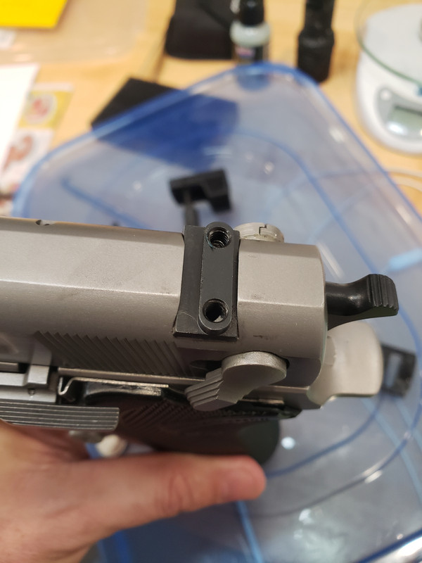

I did one using Aristocrat's mount. The same set upor close, Works great. They also make a mount that replaces the tri set sight, like on PPC 9s.

I decided that the best course of action for me would be a dovetail mount. It seems that milling the slide would be blazing new territory for most gunsmiths, so I didn't want to do that. I already have a Venom Viper (6 MOA dot) that I really want to use on this gun, so the Optima mount is out. Guzzitaco's advice was to contact Cody at Evolution Gun Works about their mounts, as the mount 49330 is thought to work with some 5906s.
I had a great discussion with Cody today. He looked at a photo of my rear sight (see below), which is the early fixed read sight (1989-1991) that is the same fixed sight as used on the Model 59. After this, near as I can tell from SCSW V4, the 5906 switched over to the use of the Novak Lo-Mount fixed rear sight. The EGW 49330 will likely work, with a few potential tweaks, with slides having the Novak Lo-Mount dovetail as this dovetail is similar to the dovetail on the S&W 1911 slide.
But that would be too easy. Cody's suggestion was to go with their model 49314, the Vortex Venom blank mount. Essentially, it's a block of aluminum with the venom mounting plate cut in the top. The gunsmith will need to mill the bottom of the block to match the dovetail size and shape in my slide. It also prevents modification of the slide in case I ever want to go back to stock configuration.
That's where it stands so far. Once I get the block, and get the block machined, I'll post some photos of the results.

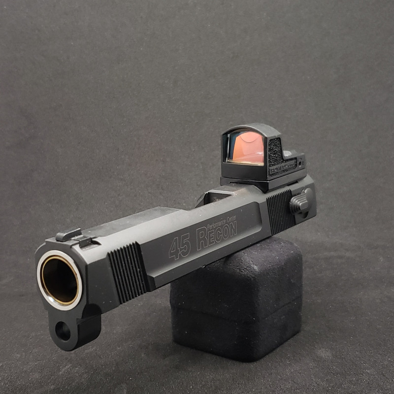

a couple of new examples:
M5906 Target Champion. EGW mount for LPA, Holosun 507K red dot.
M6946. Mount Optima/Tasco for S&W59. Ritton red dot. These red dots con be found at a great price online. Some retailers offer the combo of S&W mount + Riton red dot and IMHO it is affordable way to try the set up on your 3rd gen.
hope this helps
