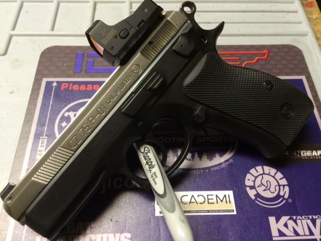

The Burris FFIII is a great sight and a great value. Don't get the FFII as changing the battery requires removing the sight from the gun and you can't adjust the intensity. The only issue with reflex sights is finding the dot in a hurry. The area of the objective lens is small and it takes some practice to get the dot in the view area quickly when getting on target. You will see guys swinging the muzzle around in a circle while looking down the sight. They are "hunting the dot". With some repetition you will find it less of an issue. I use 3 MOA on my Bullseye guns and 8 MOA on my race guns. Once I didn't properly install the screws on a Burris FFIII for my CZ P01 (below). During firing, the sight came off the slide, bounced off my forehead and then landed on the concrete shooting pad. It wasn't damaged and is still in use today (properly installed!).

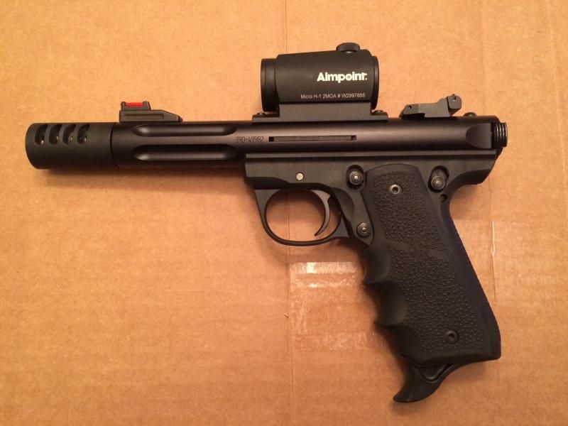

The Aimpoint Micro is a little tank. Solidly built, waterproof, with phenomenal battery life. It has a short tube and good range of variable intensities so has the benefits of the Matchdot in a smaller more durable package. I have one on a Ruger 22/45 Lite for Steel Challenge. The price is very high. The dot costs more than the pistol but it is an awesome combination. It's my wife's favorite range toy too.

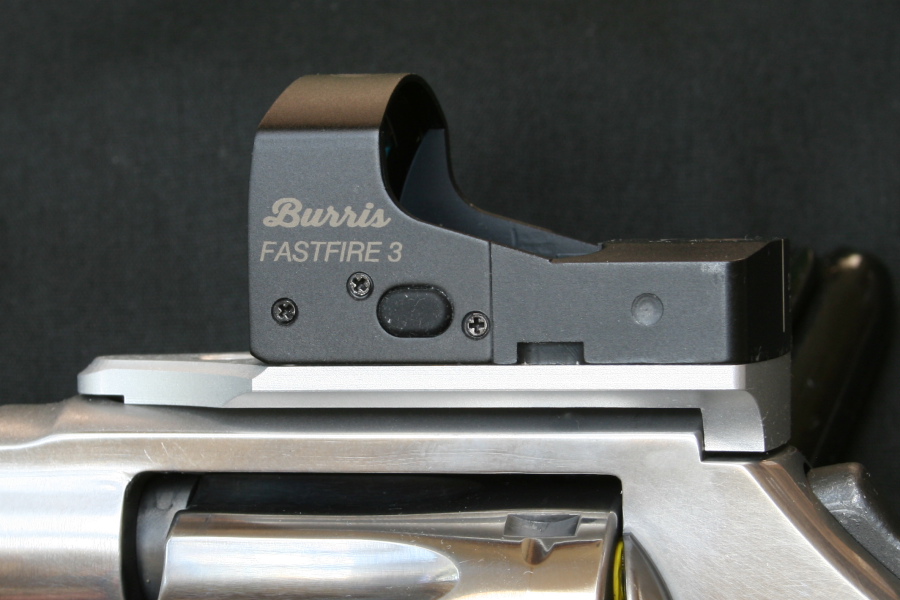

Allchin is great for the Burris as it keeps the sight low and looks clean. I have an Allchin mounting an FFII on a 686 similar to some of the photos others have posted.

The photo below is the Burris on my 617 using the low profile mount that we manufacture. I really like the compact size and low profile vs. a tube red dot.

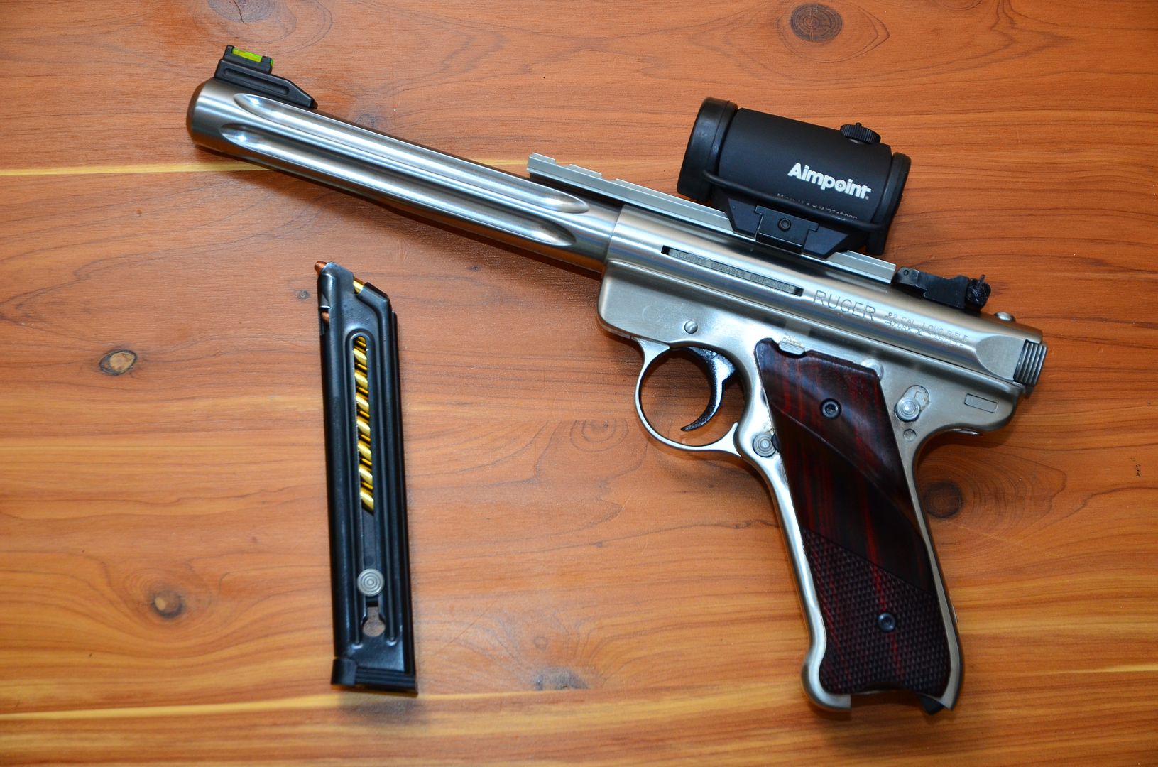

I have used red dot sights extensively with rifles and with Ruger Mark pistols. Haven't tried them on revolvers yet.
Here are some of my experiences.
Firstly, the best pistol red dot sight that there is is the Aimpoint H series. These are military-grade red dot sights that will never, ever let you down. The battery life is phenomenal due to a patented technology. More importantly, the unit is overbuilt and super-reliable. This is a small "tube" type of red dot sight and due to its small size it is perfect for a pistol or handgun such as the 617.
The Ultradot Matchdot is a good red dot sight if you do not mind the size. It costs maybe half or a little less as much as the Aimpoint. The Ultradot is not military-grade, but it is fine for most civilian uses. Incidentally, I tried the Ultradot Matchdot with a Ruger Mini 14 and it did not hold up -- the recoil eventually loosened some parts. But for a .22 rifle or handgun it should be fine if you do not mind the size.
When I first got into red dot sights, I tried some of the cheap ones that you can pick up for around $100-$150. They always crapped out. With red dot sights you really do get what you pay for.
I have not tried a red dot sight on a revolver yet, but the 617 should be a perfect platform for a good red dot sight, as the 617 is a large revolver and revolvers do not have a slide recoil to jolt the red dot sight. This is why the Ruger Mark pistols are such a good platform for red dot sights -- the recoil mechanism is inside the frame housing so the RDS sits on a stable platform, unlike most semi-autos.
One of my Ruger Mark IIIs with an Aimpoint H-1 RDS. This is a really nice combination.
