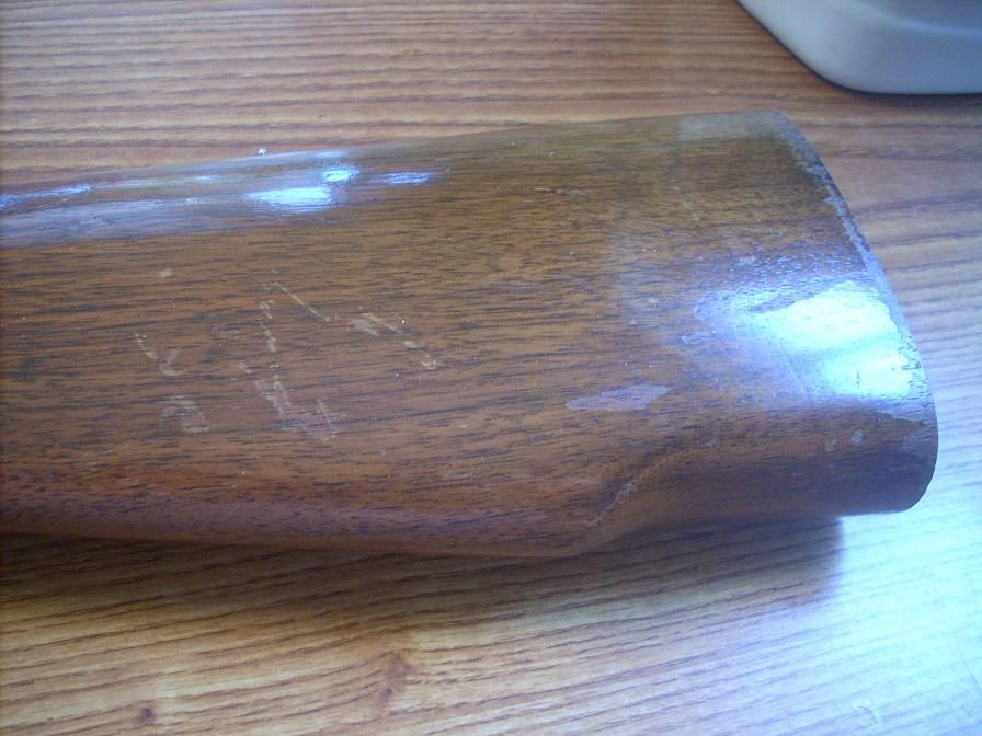

I've kinda been wanting a Remington pump rifle and stopped in a pawn shop and found an old 760 pump in .270 caliber with a cheap Tasco scope in see-through mounts. The rifle was a bit more worn than I would normally consider buying but the price was $329 and the salesman later said he would take $275 plus tax. I would say the gun was in 80-85% shape and the metal had a few worn areas but no deep scratches, and the front bead sight was ground off but a new one could be slipped in the dovetail. The stock had some minor scratches but the epoxy finish had some small chips in it. I think I could Blue Wonder the rifle and have the metal in acceptable shape but don't know about refinishing a poly-coated stock. I like an occasional science project but definitely don't want to put much money in it.

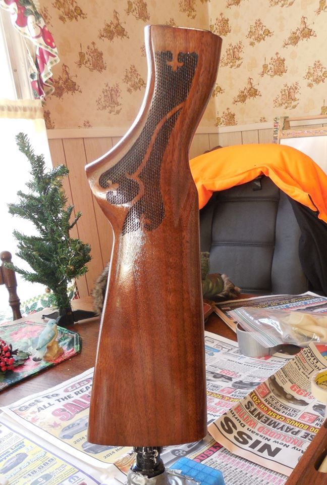

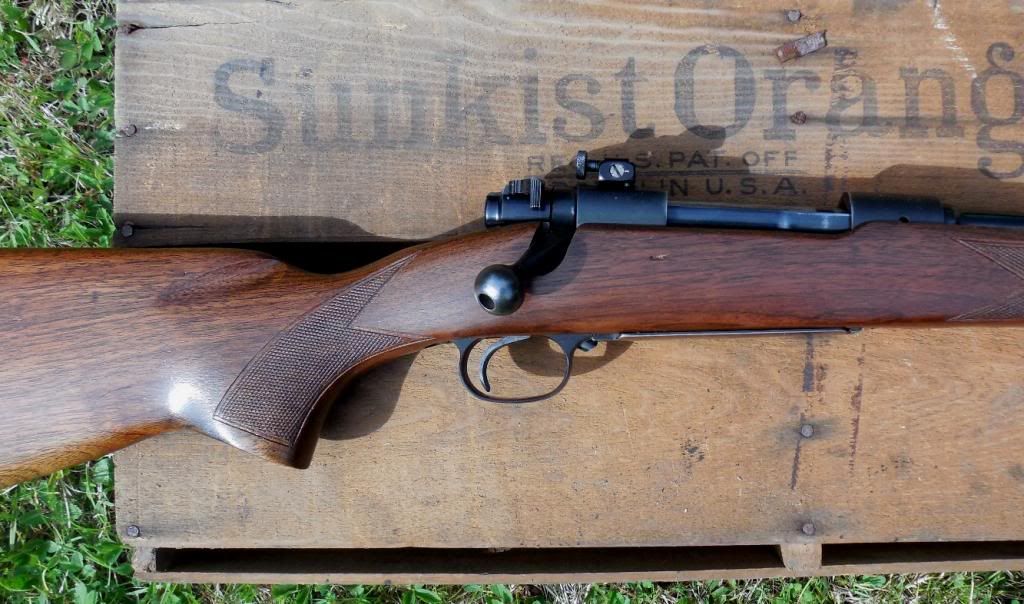

I am by now means an expert when it comes to refinishing things but I have done a few stocks and pairs of pistol grips over the last few years. I simply take some Safest Stripper wood remover, follow the instructions and get all of the old finish off and then smooth it out some, then I use Tru-Oil, how much depends on the gun. I have a few that I went just the basic on, three coats which gives it a nice sheen, and then there are some I went and did four and five coats on. How much is up to you.
Remington Model 33 single shot, original stock, four coats of Tru-oil

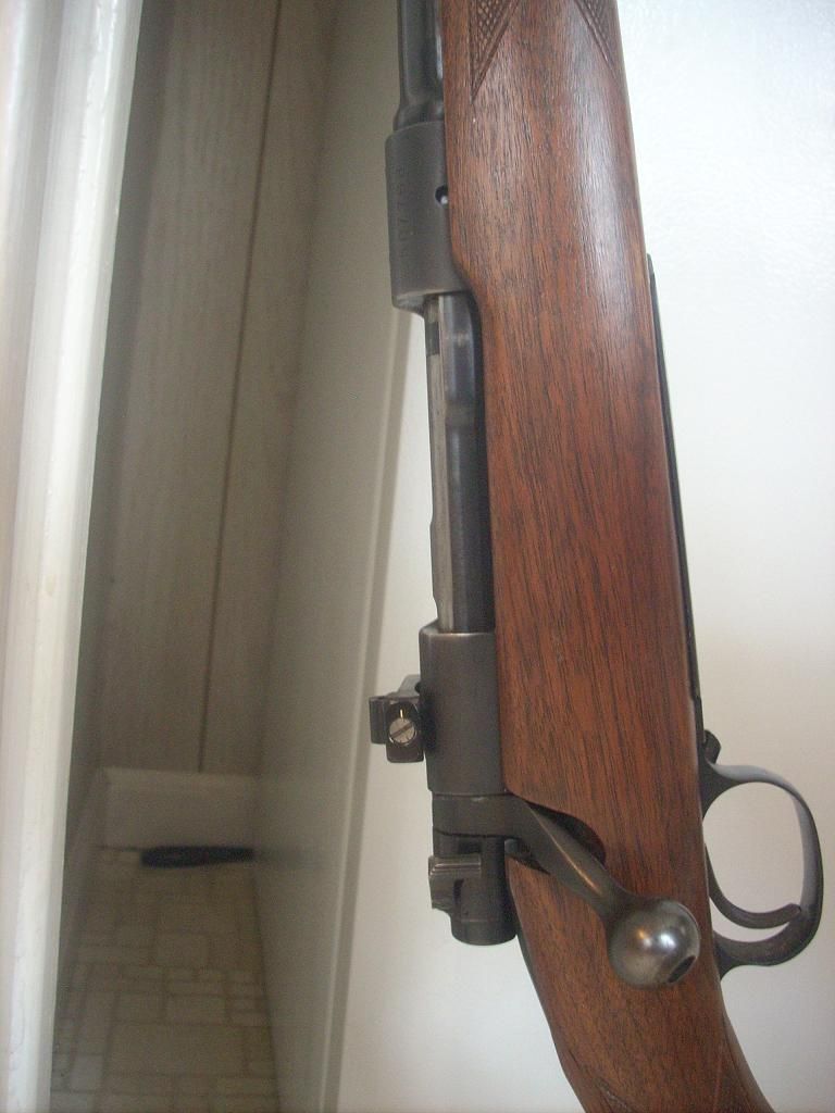

Winchester Model 70 pre-64 Featherweight

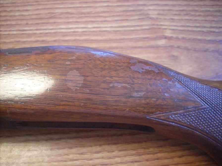

before.........

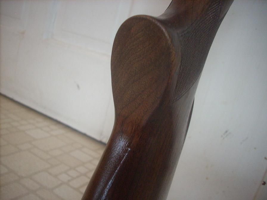

After with three coats of Tru-oil

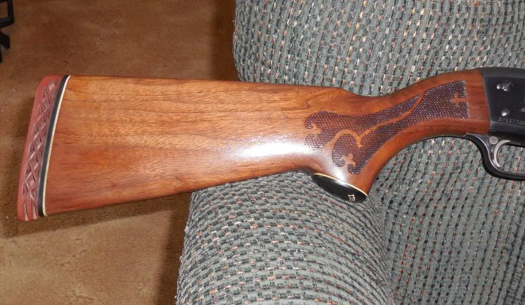

Ithaca 37 with four coats of Tru oil
