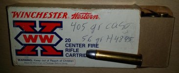

My Browning SRC loves these.........405gr. cast and some H4895. These have some moxie!!
