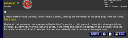

I created a video showing the excessive end-play on the rear of the Competitor's slide. Pay particular attention to the rear of the slide and frame.

Yes, I made an error purchasing this firearm. That is why I'm telling everyone here not to make the same mistake. I wanted so bad for this pistol to be worthy of my collection since it is a pistol made in USA. When I want a pistol real bad and I see it in the LGS, the need to own it overcomes my concerns for checking the gun out thoroughly. The problem is so horrible that it makes it difficult to dry-fire. You never know if it was the gun or myself. Especially while using the RMR and the MantisX.
I RMA'd the pistol back to S&W last week. I want them to fix the torquing slide to the left after the trigger is pulled problem and the loose plastic front strap. I am not hopeful that any of this gets resolved by S&W.
What I find interesting is that some shooters seem to think that this is perfectly fine. Saying things like, "My other striker-fire pistols do the same thing", "Its accurate enough" or my favorite "as long as its consistent, its not a problem". I guess these people don't give a hoot about precision just speed and it doesn't jam. Or, they could just suck at shooting and really can't tell the difference. I tell these guys try shooting a HK VP9 Tactical OR. This is how a striker fired pistol should shoot. Very good trigger and a decent precision shooter. If you don't like HK,try a Walther PDP.
