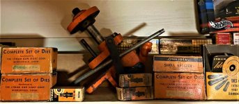

Have a Tru-Line Jr. that was given to me with a bunch of dies. Also have several 310 Tools. All sit on shelves in my assortment of stuff that I call a collection.
