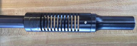

Also, the shotgun has a Cutts Compensator Body Tube with a MOD tube threaded on. Did is come from the factory with it?
