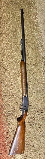

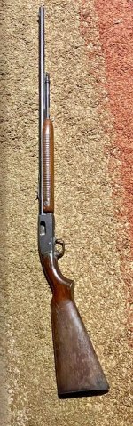

What is the possibility of finding one of these in pristine condition and what sort of price range am I looking at? Thank you.
I have been asked to find a rifle like the one in the two pictures. This is a Remington model 121, rather than a 12. My friend thinks this one is in good condition so a nice example would really shock him.

Remington made a number of variations of the Model 12 (12, 12A, 12B Gallery and 12C Target). They also made some high grade variations. Early guns weren't marked as to the variation, so you need to identify them by the features.
High condition guns are out there, but they usually don't come cheap. You can pay $700 or more for an excellent 12A and over $2K for a really nice 12C. Keep in mind that these guns should only be shot with standard velocity ammunition. The Model 121 was designed to handle high speed .22's.
