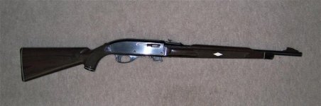

Here’s what I currently have: 341, 34, 34, 550-1, 12, 12A, Win 06 and a Nylon 10C. Didn't have a pic with just the 12’s.
