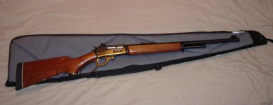

Ren Wax on both the gun and the Birdseye Maple stocks, really brought out the Birdseye figure. Punched up the color case on the CVA 1860 Army black powder revolver. Did equally well on the Marlin 444 wood and bluing.
Have used it for almost 15 years on firearms, knives, wood, leather, etc... the results you got are definitely not typical.
Sure makes me wonder what happened?
