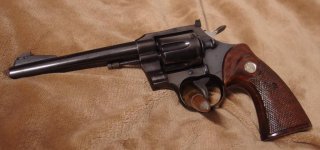

I'm looking for a 38 special revolver was thinking between the K-38 Masterpiece and the Colt Officers match but I hear the Colt triggers not as good which I tend to believe based on the Smith's I own have excellent triggers after very little tweaks. Going to use during the 2700 Bullseye matches for the center-fire portion. Any particular year or what I should look for would be appreciated.

I've owned only one Colt Officers model, and it was the end-all, do-all of pretty much any that ever were---or will be!
That's because it had been to Walter Roper's shop, where he and his lads had their way with it---grips, sights, and action job.
The best way to tell you about the action job is to tell you about a visit I made to my gunsmith----just to show it off. He sat there on his three legged stool, wearing his leather apron, and puffing on his pipe. He oohed and awed in all the right places, and then he said, "You know---I hate these (bad word) Colts, but whoever did that action job REALLY KNEW what they were doing!!!" The best way to tell you about the reaction of the folks buying my guns during the 3+ years liquidation of my collection is to tell you it fetched $3530. I reckon they thought it was something special. They were right!
As an aside, I too hate "these (bad word) Colts"! That's mostly because I had to put it together TWICE--after its welcome bath---nothing worked the first time around, and it remained a mystery as to who made the hammer, but the only thing that made sense was Colt made it----to Roper's specifications.
Ralph Tremaine
I passed up a brand new in the box colt yesterday for 1800 bucks on GB it was really hard decision to not buy it but I'm going to go with a Smith since I do my own action work on those. I have done a Colt Python action one of the newer ones but I am really impressed with the actions on the Smiths so searching for one now.
I have a 1940 Colt Officer's Model that somebody did some work on. No doubt it was set up to be a Bullseye gun. Its without a doubt the most accurate .38 revolver I've ever owned. :D

I was one of the 2 NRA Referees at the NRA National Precision Pistol Matches in 2024. To the best of my recollection, the ONLY time that I saw revolvers on the line was during the Harry Reeves and the Distinguished Revolver Matches. I saw a Taurus, one or two Pythons, a few 586/686 revolvers, but the majority were Model 14/K38 Masterpieces. The K38s tended to produce the tighter groups.
My recommendation would be to go with a K38/Model 14 ... you just can't ever own enough of them. But when you make your move, you need to make a decision: are you going to do the timed and rapid fire stages single or double action? Please remember, S&W sold the K38/Model 14 in mostly Double Action models, but they also sold them as a Single Action model and they also sold aftermarket Single Action kits so you could retrofit the revolver.
