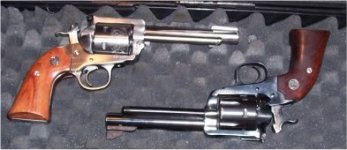

I now have a pair of 5 1/2" Bisley Blackhawks. I like them immensely. Part of it is the Bisley grip (which I thought was really dumb until I held one), but mostly it was that extra 7/8" of barrel. Changed the entire balance of the gun.
