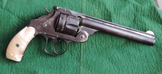

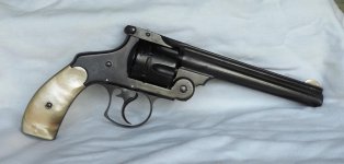

Well, some time back I picked up a pretty sad 1st. mod. DA in .44 Russian. Most of the nickel was gone and some fool had just swiped the whole pistol with cold blue without learning how to do a blue job. I did the scut work and spent a lot of time removing the remaining nickel, and cleaning and polishing the steel. I sent it to a gunsmith who did a proper hot blue job. To make a long story short, the little leaf spring in the fore part of the trigger guard broke. I'm hoping to find someone who'll micro weld the thing since parts are almost non existent unless someone has a baffed out donor pistol Pics one and two are before and after and the other pics are the broken spring. Any advice or suggestions would be most appreciated.
