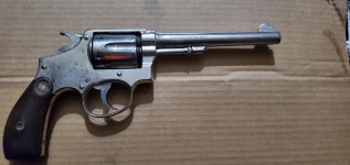

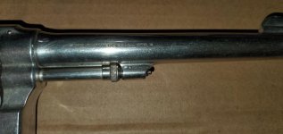

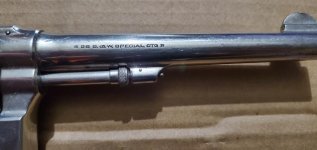

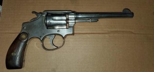

I have had this gun for most of my life, a Christmas gift from my dad as a teenager, and was wondering if anyone would help me with it's history. Serial # is 286112. On the right hand side of barrel it's stamped "38 S. & W. SPECIAL OTG".

I will guess we’re looking at 1915-1916 or somewhere in there? Round butt frame, maybe Third Change.
It’s fun to try and guess before the guys that REALLY know show up! :D
From my previous research, a few years ago, I think it's about 1911...not certain though! Lost all the info I collected due to being stupid, and not backing up a computer before it died!
Welcome to the forums from the Wiregrass! Does it have a small S&W trademark stamp on the left side of the frame. IF so, it likely shipped in 1917. If there is no trademark, then 1919. When the west coast wakes up, the folks with the databases will speak up.
I claim to know nearly nothing on these older Smitty's, so I'll only point out that the lettering actually reads "38 S. & W. SPECIAL CTG" CTG being the abbreviation for cartridge used by S&W...That looks like a very nice, well preserved old warhorse (unlike myself)...:D...Ben
I'm in S&W kindergarten here, located in the basement of S&W University, so I can't help at all. But no worries, the professors will be along shortly to really help. I just wanted to jump up out of my desk and say What A Beaut and what a great thing that you have kept and maintained that gift from your farther. Heart warming it is!
Guy is correct. Somewhere in the 1917-1919 period is a good approximation. You didn't show the left side, so we can't see whether the monogram is present. That might help us narrow down the possibilities. It would take a records search to be certain in any case.
If you look at the patent dates on the top of the barrel, you will notice the last one is December 29, 1914. That indicates the Fourth Change, which first appeared in 1915.
The nickel finish appears to be original, and so do the stocks. A nicely preserved piece. Enjoy it.
Welcome to the Forum. I just picked up a 38 Hand Ejector (M&P) Target, 4th Change with #281785. It was shipped in August 1917.
Just checked the database and find that all 1917 listed ship dates occurred between 255,XXX and 288,XXX. So 90% chance it shipped in 1917 and a 10% chance it shipped in 1918.
Let me add that the 38 Hand Ejector was manufactured, starting in 1899. Many changes occurred in the manufacture of this model and each major change was identified as a grouping of gun serial numbers. Your revolver was part of a huge production effort, a half-million plus revolvers, that lasted from about 1915 to 1942. They were called 38 Hand Ejector (Military & Police), 4th Change. Started with serial number 241,701 and continued until WWII production started around 1940-1942.
Heat treating of cylinders didn't begin until 1921 or so. Someone here can post the serial no.
I'd hesitate to use Plus P, let alone .38-44 ammo in your old gun.
s&w doesn't warranty guns for Plus P until 1957 and later, bearing model numbers.
From my notes, I find that K frames heat treated cylinders started in September, 1919, at about serial number 316648. All other frame sizes were heat treated after 1920.
