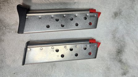

S&W 3913 magazine identification
Here are a few close-ups of the front and backside.

Very early on, S&W shipped the 3913s with a different flat based magazine, one round fewer, fit completely flush with the grip frame, than the later version they switched to, and we're most familiar with. As I recall these early flat based mags han a slightly shorter mag body, thus one less round, and used a metal base like the ones you show here. I'm not sure, but..... that may be the issue, if you're trying to install these early style bases on the later mag body. The lips of the later mag body might be different so as to accommodate the plastic flat and hooked mag bases. BTW, these early truly flat based mags are quite rare and most folks might not even realize what they are.

As I recall the 3904/3906 mags were initially 8rd red/orange follower plastic base - similar to the 39-2 and 439 8rd mags except for baseplates and followers. As I recall the 3904/3906 mags work in the 39-2/439 but they stick out slightly - while the 39-2/439 mags do not work in the 3904/3906?
The 9rd 3904/3906/909 mags were available later as replacements taking advantage of the additional metal sleeve length after the 3913 came out with the shorter 8rd capacity mags and the 9rd mags came standard with the later 909 pistols - so be aware there are longer 3904/3906 geometry 8rd mags similar to the one pictured except for round count markings which may be confused with shorter correct 3913/3953 8rd mags. Dont assume an 8rd single stack 9mm mag is the 3913/3953 variety.
And yes the 3904/3906 mags will work in a 3913/3953 but they will stick out exposing part of the metal sleeve at the base. I seem to remember an old post saying that the feed area at the top of a longer mag was damaged by repeated hard insertion of the mags in the shorter grip without a spacer but maybe that was a 5906 mag in a 6906.

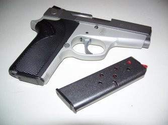

I bought a mag sleeve for a Kahr MK9??, unsure of model and modified it to work on the 3906 mag in the 3913 to take out the gap. Works great. I carry the standard 8 round with finger groove in the gun and the extended 3906 mag with spacer as backup.
I picked up (2) 3913 mags and didn't realize they were the 7 round short mags until months later when I got them out to try out. Lucky me huh?, no really. Kept one in the future event I get a 3913 TSW with recessed/short grip and sold the other to a buddy who had one of those already and didn't have a short mag.

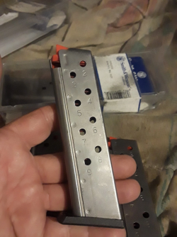

Mag comparison. These are all 3rd gen.
