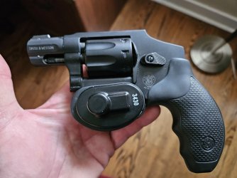

I own the only good one I've ever heard of. Actually not good, but great. I bought it new in December '23 and it has been flawless. Shoots cheap ammo accurately and ejects spent shells easily. My son qualified for the pistol range with it when he was 13 and the wife enjoys shooting it and keeps it in her office. I use Remington Thunderbolt and Federal Champion rounds and they come right out.
This was my first .22lr revolver and every one I've bought since absolutely sucks in comparison:
A new 617-6, two 63-1's and a Charter Arms Pathfinder are all up for sale, but I won't be selling the 43c.
Everyone on the forum has bad luck with them but mine has been perfect, Knock on Wood.
