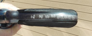

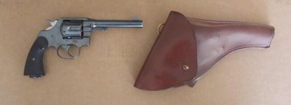

I have a Colt New Service revolver, .45 Colt, s/n 143307. Made in 1917 and the back strap is marked for the Royal North West Mounted Police.
