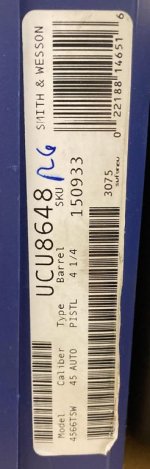

Great info and analysis - you can extend low end a bit.
WVPSC UCU range lowered to UCU8648. If you have a pic of the pistol with the serial number showing I can add it to the post.
Interesting note:
UCU8648 and UCU8697 have a Julian date of 3075
UCU8797, UCU8844, and UCU8853 have a Julian date of 3074
So the lower serial numbers were labeled a day after the higher serial numbers.
