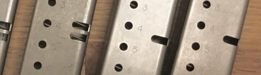

Can anyone tell me the difference between the 845 and 945 magazines? I finally found and purchased an 845 and want to buy additional magazines. I have some 945 mags but they do not interchange. Thanks.
Location of the magazine release notch.
645, 745, 845, 4566 and 4506 magazines are basically all the same and are interchangeable.
The 945 magazines are specific and some early ones were actually made from the already existing ones. These will have two mag release notches.

The 945 magazine is absolutely exactly the same as the gujillion of 4506 magazines made for decades, except for a higher notch just as Jim said. There is no other difference.
And yes, the 845 will happily use any/every full size S&W 2nd or 3rd Gen 8-round .45 mag made except the 945 magazine and if you do have one of the early dual-notch magazines, it will use that one also.

Sevens, I have a dual notch magazine and it would not work in the 845. I did not want to force it. I will try it again and let you know. Thanks.
It needs to be a dual-notch magazine and it is certainly not meant for the 845 or 4506, and if you are doing speed or stress fast reloads, it is not a good magazine to use.
With that said, if you push the magazine release button in while you seat the magazine to move beyond the first notch, it does lock in properly, feed/fire/eject brass, and pushing the release will eject the magazine as intended.
