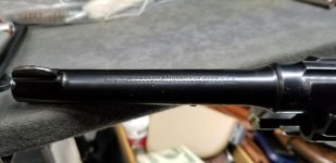

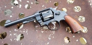

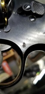

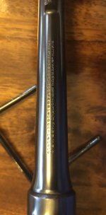

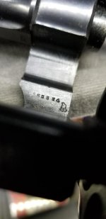

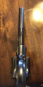

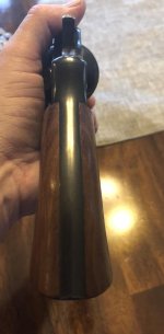

Hi Guys,
I just bought this. It will be in my hands next week. This will be my oldest S&W. I’m a little leery about the outcome. What did I get myself into?
Please take a look and let me know what I have. Can I get an approximate date and value on it? No rust or pitting on the gun as stated by the seller. All numbers match as the pictures illustrate and has appropriate rollmarks and ordinance stamps.
I’ll add some more pics here in a while.
Thanks,
Mike

I get a 1918 date when I put in your s/n. Good looking gun! I'd say the value is what you paid for it.

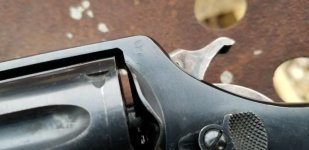

Ha! Thanks! It’s worth what the seller and buyer decide what it is.

What are you worried about?
I paid more for one in worse cosmetic condition. You won't have any problem getting your money back if you aren't happy with it. You will love moon clips, but DO get a moon clip loading tool. Not all rims are the same, and some of them are TIGHT to get on.
In that condition, with that serial number (old enough to have seen service in WWI) they usually go for $900+.

Generally I was worried about buying something that I’m not 100% knowledgeable about. I saw price ranges from $700-$2500.
This was not like buying an M27 with “3 1/2 Barrel where the market is well established. This will be the oldest gun that I own.
Finish looked good and roll marks looked solid so I took a chance. I’ll have to put some rounds down range and give an update.
Thanks for your insight.
I think given the condition you made a really good deal. I have bought 5 over the years, all for less money, but not nearly in that nice condition.
I really enjoy shooting these, and hope you will too. You're just down the road from me!

So, I picked it up this afternoon. I was not disappointed as the pictures illustrate. I promptly broke out the Hoppe’s No. 9 and Renwax. She cleaned up very nicely.
The Grips number to the gun. I have no idea how to rate this gun but it’s gotta be pretty high in my estimate. Any opinions would be appreciated.
Trigger is smooth as silk. Lockup and timing are what you expect.

More pics. I wish I was a better photographer! My pictures do not do this gun justice.
