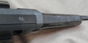

I have had help getting some more information. Michael has informed me this was a 5 screw Model 27 that shipped in 1955 to a dealer in Minnesota. The cylinder is recessed and is marked with the original serial number on the rear face and underneath the extractor. I assume in the conversion from 357 to 44 someone bored out the original cylinder.
There is no serial number in the extractor cut under the barrel. If anyone can opine I have been told it is an original Model 24 barrel based on the stamp. However the top of the barrel is checkered to match the normal checkering on a Model 27.
Overall, the work appears quite good. I am hoping that I can find out who did the work. The original owner was a Lt Col in the Air Force who lived in the Austin, Texas area.

I for one really like NICELY Customized revolvers - guns touched by master craftsmen in a way that makes them one of one (hence the reason I like hand engraved guns so much). That 44 appears to meet my definition of Nicely Customized.:D The checkering on the 44 Special barrel rib shows an attention to detail that I am guessing permeates all of the modifications.
I also really like the 357 Magnum Revolvers (RMs, NRMs, Pre-27s and 27s) with all the cool features (i.e. checkered top strap, recessed cylinders, etc...). What you have is a 357 Magnum, calibered in 44 Special, and that is very cool.:cool: As noted, one of the things that would increase the value to any future owner is some of the history of (i) the gun (who did the modifications and when were they done), and (ii) its previous owner.
