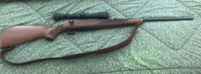

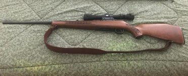

I cannot help with reload info but I can share something I found with my 340 (22 Hornet).
The metal to wood fit is critical with these barrel nut style rifles. I'm sure your friend has already checked this but maybe not, so check the tightness of barrel nut to recoil lug, and the tightness of barrel band to barrel band nut.
Those two fits could affect group size no matter the load or the competence of the shooter.
I for one really like the Savage platform of days gone by, but they were a cheap, working man's rifle...and I don't think they were meant for tack-driving duty...but they could do it!
