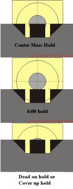

Folks,
After shooting 500rds through my SD9VE, I start to figure out that the consistent lower left hit is not caused by my shooting skill, but the sight is misaligned. The front sight is obviously shifted to right. So I was wondering, is there any simple way to get this fixed? Also, how about the elevation adjustment of the rear sight since it consistently shoots low?

Are you covering the target with the front sight or is it at the 6 o'clock position when you aim?

Hi I am a right-handed. This might be caused by learning curve, but the front sight is obviously drifted to right. I measured it with a ruler, and there is approximately 1.5mm difference.
Low left is 9 times outta 10 shooter induced. Take a punch and a hammer and drift the sights to dead center and if you're still seeing low left hits, add some dummy rounds into your mags and see if you are anticipating the recoil and flinching.
I found that I personally have to cover the target with the front sight. I used a bore sight and it confirmed this consistently. Once I knew my point of aim with my iron sights I aligned my rail mounted laser also using the bore sight and even that red dot was consistently behind the white dot on my front sight. Every shot at the range is dead on after finding out what my point of aim and point of impact were.
The other member's suggestions are true as well. Training to use proper trigger pull and not anticipating the shot have tremendous effect on round placement.

The only pistol I have ever had to use a 6 oclock hold for is my friends XD9 service model. On the SD I cover where I intend to hit with the white dot of the front sight and if i do my part it will put the round where the dot is covering.
I brought it to the gunsmith today, who has the front sight adjust tool. He said he has seen a couple of SD9 with misaligned front sight and it took 2 mins for him to fix it. Then I tested fire at his range, and now it hit in the lower middle of the target. I believe you guys are right, 6 o'clock hold is not ideal for this model and I will try center cover or dead cover later.
