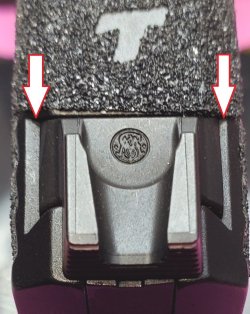

I have BG2.0 and everyone that shoots mine does go out and purchases their own (7 other so far). I drifted my sights (any my buddy's sights) until POA = POI. That is front sight to the left and rear sight to the right so that neither sight adjustment would be too extreme. Even with oil, the sights were a bear to move - especially the front sight.

My pistol also consistently shoots to left. The groups are small and consistent and I have not experienced this with any other pistol. It does this all the brands of ammo that I have available and has for every one I have asked to test fire it. The POI seems consistent with the experience of others. I am in the process of drifting the sights and it is improving but will take more adjustments and verification. I moved the front sight but not find it to be misaligned to begin with. So the question is, What is causing this issue?
Might seem stupid, but if you shoot tight groups you are fairly consistent. If you move the sights as far as you have and still shoot tight groups to the left with the same sight picture, then the problem is likely you. I would suggest, if you are a righty, try moving the trigger finger to the left, ie, put more finger on the trigger. I had the same problem when using the pad of my finger, moved the finger so the trigger is in the first joint, and solved the problem. It does take a little practice to train your finger to go in the right place, but it does work. On one gun (I have small/medium hands) I had to change the grips to accomplish the natural grip but it did work.
