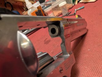

Hi,I recieved my 617-6 back from Smith today,it took 1 month.It was spitting lead really bad and hitting me and my fellow shooters.The factory stated they Cut Forcing Cone,Repaired Yoke and Replaced Rebound.I haven't had a chance to shoot it yet as our range is closed for repairs to the roof.I hope the issue was solved,the forcing cone doesn't looked touched to me and there are no burn marks from firing.Jay Parisi
