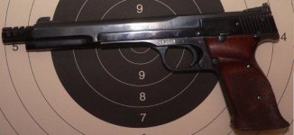

I would like a new frame for one of my 41-1s
I would expect it to be given the same serial number....
