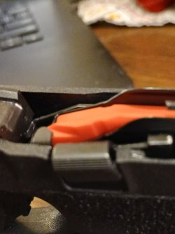

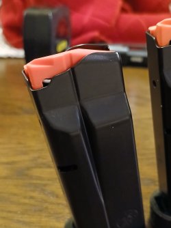

I finally got a chance to see if I could identify the specific cause and, in my case, this is it -- The tab on the magazine latch and the shelf on the follower completely miss each other, with the tab of the latch ending up resting against the follower well below the shelf that it should engage. The tab digs in to the plastic of the follower and makes the magazine hard to remove and the tab rubbing against the follower raises the latch just enough to cause the slide to almost catch, but not quite. Each one of the malfunctioning followers has a ding in the body of it from the tab biting it.
The magazine that does work just barely engages the tab of the latch - just barely.
No - it's not a lack of force lifting the follower. Springs with 50 pounds of force wouldn't work if the two parts miss each other. It's also not my thumb getting in the way - I'm a lefty and my thumb is on the wrong side of the gun for that.
A fix that I did try -- All 5 of the followers I now have seem to be dimensionally the same. There does seem to be a bit of play of the follower within the metal of the magazine box. Considering that the spiral of the spring could be torqueing the follower, rotating it away from the latch, I removed the spring, grabbled it at both ends and gave it a 180 degree twist. This distorted the spring just enough that it should push the follower shelf toward the tab when inserted back into the mag.
It worked! - Once. Locked back just as pretty as any magazine ever did. And then went back to the same old problem. S&W needs to do a latch or magazine/spring/follower redesign. A tab that extends inward and/or back might to the trick if it doesn't get in the way of anything else.
I could try to provide photos if anyone cares to see. Edited -- I added a photo with the slide removed so I could get a photo. This is what is happening. The tab completely misses the flat on the follower. The result is the tab doesn't get pushed up to lock the slide.Missed follower.jpg

No good, sir. The tab on the lever completely misses the flat on the follower. Things just don't line up like they should. I did a real close shot with my macro lens to show this. Have a look at the attached photo. It's as if the tab on the slide lock is blunted or malformed. But another 10 round magazine and a 13 round works. If the follower either stuck inward a little more, it would work fine Missed follower.jpg

I could try to provide photos if anyone cares to see. Edited -- I added a photo with the slide removed so I could get a photo. This is what is happening. The tab completely misses the flat on the follower. The result is the tab doesn't get pushed up to lock the slide.View attachment 758953
Second photo shows where the slide lock tab misses the flat on the follower and ends up digging into the front left corner of the follower, producing the notch circled in white. This then makes it difficult to remove the magazine and leaves little red/orange flakes of follower material scattered inside the pistol.
My shield plus 2.0 works just fine with all mags and locks back on empty, but looking at mine and looking at yours I see a major difference......You have way to much orange showing above the lips of the mag......check your springs in the mag that does not work....here is mine

I see what you are getting at. But the reason mine shows more red is because the tab on the latch is not holding down the follower like it is in yours.
Could the magazine latch be forcing the mag to the rear for some reason? My gun kinda looks like the lock tab is bent upward, like the tab didn't get bent to a full 90 degrees during manufacturing. All four of my mags seem to work OK,on the bench....have not fired the gun yet. Any chance the tab got bent to the left--maybe the orange chamber plug caused a problem by being out of line when the slide got released.
