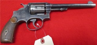

I had been following a tired and slightly worn Model 1902, 1st Change revolver for some time on Gunbroker. Found it last year listed at over $700 and talked with the seller, Jacobson's Gun Center, about a better price. They stated that it was a Consignment and the seller would not go lower. Over the last several months, the starting bid kept going down a little at a time, but still too high and no one placed a bid. I am sure many members here saw the gun as well. I ran across it again recently and it was down to $510 plus shipping so I decided to contact the seller again. This time they were ready to make a deal and sent it along to me. Kudos to Jacobson's, Story City, Iowa, as it was a pleasure doing business with them.
I have just a few 1902s and notice that the market for decent examples is really drying up, so agreed to pay $475 for the gun with factory letter, knowing that the pre-1910s round butt stocks are selling for over $250 today, that is if you can find a set anywhere. I was pleased that the metal was smooth and the bore and chambers were mirror.
It needed some help so I decided to use some Oxpho Blue from Brownell's and go over the gun, leaving the existing metal as it was. In its original condition, I saw no downside. The results were very pleasing, leaving the existing blue unchanged and darkening the rest of the gun to a pleasing vintage look.
The stocks were also worn and dirty, so decided to give Curt (44magget) a try after reading some members recommending him. I was very glad I did, since the stocks returned to me in less than two weeks and look perfect, I mean perfect factory original with linseed oil matte finish, just as they were done at S&W. The very fine early style checkering was flawless. Check the before and after images.
I guess persistence and some elbow grease pays off once and a while! Hope to shoot it soon. I am happy to breath some life back in a fine old revolver that deserves a better life.

Very nice revolver! Curt sure knows his stuff doesn't he. Can't wait to see how the old gun shoots.
Nice work, both the bluing and the work on the stocks. I imagine that Curt first gave the grips a good soaking in acetone, to draw out all the old finish. The dark grain lines on the grips have a purplish tone to them - maybe that's just the lighting, or the camera?
Regards, Mike
. . . I imagine that Curt first gave the grips a good soaking in acetone, to draw out all the old finish. The dark grain lines on the grips have a purplish tone to them . . .
I asked how he cleaned the wood and Curt said he did not use any solvents. He carefully sanded and polished with steel wool. The re-checkering took care of themajority of the grungy center. I am thinking he did not use any stain, but those colors you see are there in the wood.
