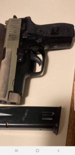

I have the chance to pick up a Sig P228. It is West German made with proper markings. Are these durable firearms? I read something about stamped steel slides. Please advise.

Any ideas on value? It has been cerekoted.

The slide is stamped and welded thin sheet metal. The breechblock is a separate piece that is held in place with a roll pin that is supposed to be replaced after so many rounds. The frame rails are thin aluminum alloy that can crack if hot ammo is used that causes the thin slide to flex when fired. Cerekoted? I’d pass unless it was cheap. But the Sig fans will now chime in and tell you that I know nothing. There are better and more durable guns out there for reasonable prices.

I qualified and carried one on duty several years ago. I lost count of the rounds at about 6000, with no issues at all; a lot of those were Plus P loads. Very little wear after so much use. It was very reliable. I spoke to a local FBI agent back then and he said he carried his Sig 228 for several years and had approximately 15000 rounds thru it with no issues. If cheap enough, I would get another one. As stated, the Cerakote does not help the value of the gun. I would say $500 max, and it would have to come with several additional high capacity magazines. Good luck.

I can't tell from the picture. Is the finish on the slide damaged or is it just dirty?
If the cerakote was well done and in good condition, I might go up to $400 on it. I actually like the stamped slide guns. In my hand they balance a bit better. I've had my P228 for 24 years and love like I did day one.
