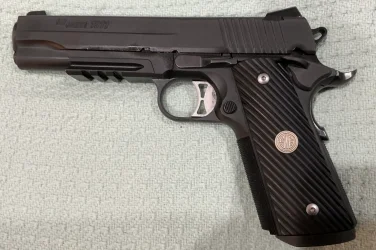

After over 3 hours of work its pretty good. Disassembled completely, stoned trigger slots, sear job, touched up hammer notch, stoned disconnector and dumb safety levers. Machining is Very good like a Tisas, back together, stretched external extractor spring, adjusted trigger stop and trigger is under 5#, happy. To range next weekend when down near Tampa.
