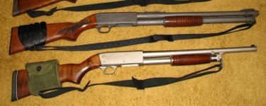

Also note Ithaca made three different trigger groups, the original with a secondary sear and trip lever that will fire with the trigger held when the action is closed, the most desirable with a disconnector, and a cheap version with no disconnect that allows the hammer to follow, but will not fire. That can leave a live round in the chamber with the hammer down. That version was intended for sporting guns but found it's way into police guns too. #1 and #2 both require an educated trigger finger, but for the opposite reason.

SEXY Ithacas! Mine looks just like the third from the top. Long tube, no sights, simple, basic. I like it. Mine is parkerized without the little "hunting scene" on the side of the receiver. Does anyone know when they stopped that engraving? I've seen guns before and after mine with it, but mine is without it, also what is the breakdown on the blued v. parked guns?
