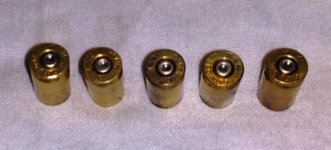

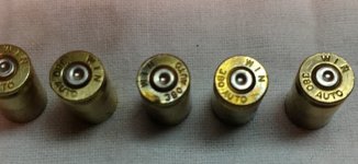

Just out of curiosity tonight I loaded a few primed cases with CCI Small Rifle Primers in .380 brass just to confirm whether or not you could get reliable ignition in a striker fired .380 with SRP. In this case fired in a Belgian Browning Pocket. 5 rounds were fired and the primers are shown below. Do any of you honestly believe that the firing pin impression in any of these is marginal in the least way? I am looking for those who have real-life personal experience doing this, not stories of what you have heard, read, believe without evidence, etc.
Here are the pictures:
