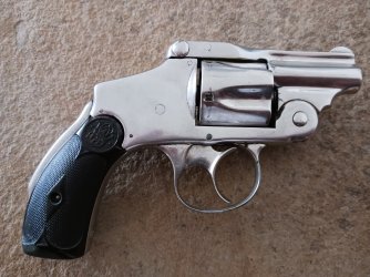

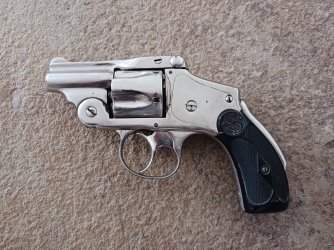

Very interesting thread. I have a gun that letters as a 2-inch barrel, but some think it is not original.
My gun is a .38 Safety Hammerless 4th Model. It has a forged front sight. SCSW 5th Edition says the forged front sight did not happen until the 5th Model. Plus has a few other things make it look like not factory quality work according to some. It has been poorly refinished in nickel and is heavily buffed. The only serial number that I see is on the butt. Looks like 7820 on the rear of the cylinder. Don't see any patent info but may have been buffed off. Marked .38 S&W on the left side of the barrel pretty well centered and has dingbats on each end. I have emailed Don Mundell questioning the information in the letter. Here is a pic of the gun and the letter.

With the heavy buffing and the replate, it's difficult to ascertain what is original. Do the serial numbers on the barrel and barrel latch match the butt serial (182033) or the cylinder (7820)?
The barrel markings should look like these two photos. The 3rd is a close up of your barrel. Looks like there is something remaining but I can’t make it out.
Murph
Thanks, Murph. Don't see anything on the right side of the barrel. Probably buffed out.
Left side looks just like your example. Faint, but can see .38 S&W CTG with a dingbat on each end.
Also a photo of the right side of the gun.
Dare,
I like your gun and I believe the barrel length is legit.
This is just my opinion but if it was mine I would lose that heavily grinded cylinder since it doesn’t match anyway and replace it with one that isn’t worn. I’d also consider removing the chrome finish which actually if done correctly will reveal more markings on the barrel since it’s very heavily plated. That normally covers soft markings. Then replace the triggerguard and remove the chrome from the trigger.
All of this done right would definitely increase value big!
