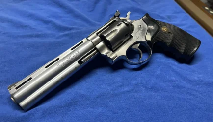

Also called the Smython, first built by Davis to include the front locking point. Idea was to combine the Python barrel, which featured a "choke bore" barrel which tapered .001" from breach to muzzle, supposedly increasing accuracy, with the S&W action which most preferred due to its consistent pull through double action versus the Colt's "stacking" action. Others mimicked the platform. Mine was done by Lin "Trapper" Alexiou and replaced the end-of-ejector-rod lock with a crane-mounted ball lock; in theory but not practice similar to current S&W design.

Here is mine:
