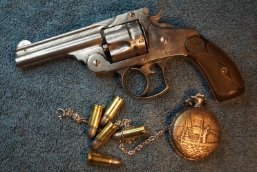

The one I'd like to address here is a Smith 5 shot, top break, that appears to be approximately.38 caliber, but I'm not certain of that.
A modern .38 Spl round is too long for the cylinder by a bit, and wobbles slightly in the cylinder bore, not snug like in my 1967 36 no dash.
I'm not at home, and won't be for a couple months yet, so I have no way to measure anything, with other than tape measure accuracy.
Basic dimensions are 7 5/8" OAL, 4" hgt, with a 3 1/4" barrel, and a cylinder length of approximately 1 3/16".
The gun is flattopped across the length of the frame, the barrel is also flattopped, with a rail shaped top. It seems to be DAO, but due to serious lack of attention, that could be a fail to function properly issue. In any case it will not cock manually. It is a square butt, small handled, has Bakelite grips with the diamonds, and the S&W logo moulded in at the top. The front sight is a thin, half round blade, pinned to the barrel, the rear sight is a tiny, tight V, and part of the break mechanism.
The rear of the trigger guard comes straight down, is not really rounded like newer revolvers, but is very slightly arched. Front of the trigger guard is normal S&W. The trigger is also different than anything I'm familiar with. It has a spur to the rear side that forms a rounded notch, seemingly to perform a function when pulled, that I haven't yet figured out.
There is a small, single screw sideplate on the left side, next to the hammer.
On top of the barrel is stamped 4 different Patent dates, from, as I recall, January 1865, through July 1880. Finish is......... well, WAS shiny chrome.

Based upon your description, you may have either a 3rd, 4th or 5th Model .38 Double Action. These were made starting in 1884 until 1911. A serial number would narrow it down as for which model it is. These revolvers are known for their broken/non-op single action function. Unless they are in pristine condition, they are not worth very much.
Numbers on the butt are 60476. While I am a shooter, I'm not very knowledgeable about dating, but I always thought production of models, following granted patent applications, came fairly close. If this is what you think, what is the official name of the round it uses, not that anyone plans to shoot it? This one is a long way from being pristine, and not much is expected, I don't think, assuming anyone would even want it.

The cartridge is a .38 S&W. The bullet is .361" which is why a S&W .38 Special (.357") wobbles in the cylinder. Some call the .38 S&W round ".38 short". I believe that nomenclature was based upon C**t cartridge designation.
Surprise! The 60476 serial places it in the middle of the .38 Double Action 2nd Model production. The serial numbers are from 4,001 to 119,000. They were manufactured from 1880 to 1894.
