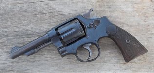

[FONT=&quot]I've attached photos of my particular example of this genre, chambered in .38 Special, branded under the name N (for Norberto) Arizmendi y Cia located in Eibar. While in overall appearance and function it's analogous to S&W's Military & Police model, its design differs in one significant respect, in that it lacks a removeable sideplate. Access to the lockwork entails drifting out two pins to remove the trigger guard, necessitating that any servicing be done within the cramped confines of the solid frame. On the other hand, the external machining and finish are decent. In double action it's smooth enough, and the single action trigger pull is crisp, although both require rather too much effort.[/FONT]

My very first CF revolver was a new Spanish Llama .38 Special snubby, back in the mid-1960s. It was a near-identical copy in every way of a S&W Model 10 snubby, aside from having its firing pin in the frame instead of having the firing pin in the hammer, which, strangely, was nickel plated. As I remember, it set me back about $60. It was my house gun for a long time, but I eventually sold it. I can’t complain about its performance, but I doubt that I put more than a few hundred rounds through it. It was well-made and did what I bought it to do.

To the best of my knowledge ( which is limited on foreign copies) I believe this To be a Spanish Trocaola. There is a really good article about these on “Forgotten Weapons” ( Eibar Spanish model 92). An article by Mike Burns details the history of this revolver, and has excellent photographs. This revolver is actually well made inside & out.
I believe it is chambered for the 8mm lebel.
According to the afore mentioned article, these revolvers were supplied to the French during WWI
It came to me with the Pach’s, and it has obviously been carried.
OP, if you have further insight into this revolver, any information would be appreciated.

loc n load - What is the cover over the hammer on your Trocaola? From the pic, it looks like it may be hinged?
Larry
Larry,
It is an integral part of the hammer. It is solid. It is a generous hammer spur. I believe a portion of it was blued.
I took some more photo’s of it for you.
I included a photo of a hammer spur from an identical model from the afore mentioned article. It is not blued.
This revolver came to me in a lot that I purchased at an estate sale. This revolver was tagged as a S&W 1904 4th change, the hammer spur threw up one of many red flags. It was also tagged as a 32-20, but it is not.
