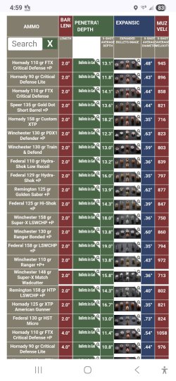

I have Model 36 2"and I'm looking at self-defense loads for it. I understand all the arguments stating that most +P ammo only produces more flash and recoil in a short barrel. However, the Speer 135 grain Gold Dot + P that the manufacture claims is tailored for short barrels has caught my attention. Does anyone have personal experience with this round and barrel length? Specifically, has anyone chronographed it or tested it in ballistics gel?

I do not remember if I ever chronographed this ammo or not, but it is my preferred carry load in my S&W 640-1. Lucky Gunner did test this load, along with lots of other loads, for velocity and gel performance.
Link to Luck Gunner's tests:

The Lucky Gunner tests show the Gold Dot's expansion to be a little iffy out of a 2" barrel. The Federal HST balloons pretty reliably. I also like the Remington Golden Sabers. I'm partial to BIG hollows in my hollow points.
Good luck finding Federal's 130 grain HST ammo, it was discontinued some time ago. The Speer load was the last ammo issued to NYPD officers who still preferred a revolver. The load earned a good reputation in use. I do agree, the Remington 125 grain Golden Saber looks like it would be a good performer, even from a 2 inch barrel.
